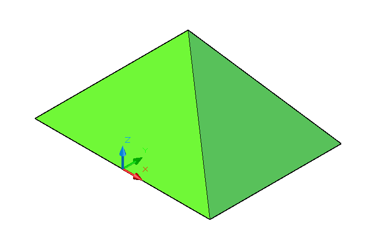

Casusa Posted February 17, 2012 Posted February 17, 2012 Hi. Can you help me with a simple one? A square roof and 4 equal faces. Thanks. Quote
ReMark Posted February 17, 2012 Posted February 17, 2012 Hi.Can you help me with a simple one? A square roof and 4 equal faces. Thanks. Is this a gabled roof? You'll have to post an image or a DWG file so we know exactly what we are talking about. Quote
Casusa Posted February 17, 2012 Author Posted February 17, 2012 Hi. Here is a dwg, i think i've atatched him right. ROOF.dwg Quote
topcadexperts Posted February 17, 2012 Posted February 17, 2012 Hi.Can you help me with a simple one? A square roof and 4 equal faces. Thanks. Hi Casusa, Try this step by step http://topcadexperts.net/blog/2009/05/17/hip-tip-3d-roof-in-autocad-20042010/ The only diference is that the 2D shape is a square (better saying a rectangle). Quote
ReMark Posted February 17, 2012 Posted February 17, 2012 It would certainly be most helpful if you could tell us what kind of pitch you had in mind too. Just curious. I get dimensions on your rectangle of 3x4. That's meters? Are you creating this roof as a solid or a surface? Quote
Casusa Posted February 17, 2012 Author Posted February 17, 2012 Hi. Yes 3x4 meters, is simple concrete roof, and the idea is doing it as a solid. Thanks Quote
ReMark Posted February 17, 2012 Posted February 17, 2012 Here is one way to give the appearance of a roof. Created using the 3DPolyline and Region commands. Shown using the Conceptual visual style. Roof at peak is 2 units high (using your base drawing). Quote

SLW210 Posted February 17, 2012 Posted February 17, 2012 You could also _LOFT the base to a POINT. Quote

Casusa Posted February 19, 2012 Author Posted February 19, 2012 Hi Casusa, I would like to learn from you if you have seen my Hip Tip. Cheers Yes i did solve the problem using your tip. Thanks again. Quote
