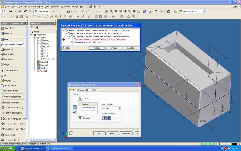

Hello, can help me anyone? How to close (to bend) the box in sheet metal? I cant bend the last sides (where are the work plans). I must to made two items for close the box....
That box can be made with two features.
No extra workplanes required.
Sketch 1 is a simple rectangle.
Sketch 2 is two simple lines - 1 vertical and 1 horizontal.

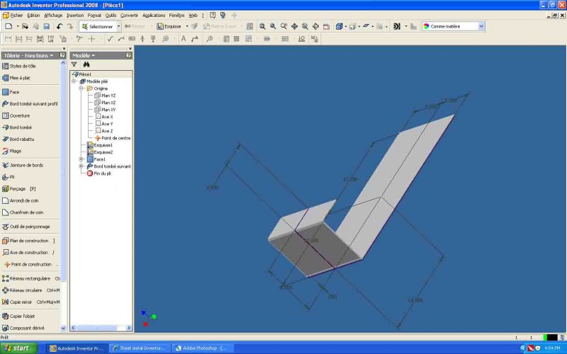

Thanks a lot for your help. Unfortunatly I cant do it. In the first try, the box became double??? In the second, I could generate only one side....Somthing is wrong in my routines. Do you have a suggestion? Thanks in advance.
