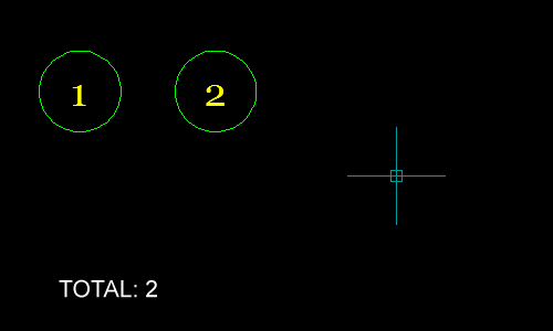

Can anyone help me realize this?
With permission of Lee-Mac this List (http://www.lee-mac.com/autolabelattributes.html) offers a great help, giving us the possibility of knowing automatically, by attributes, the total number of a block (A). This value is an attribute.
Could have one text that would give us the highest value of the attribute of the block (A)?
I would like something
New text I can move?

You have almost answered your own question in Lee's code above he refers to using reactors the TOTAL Num would be an additional reactor if the blocks are changed then the Total number is updated, somewhere in Lee's code there will be a way of counting up how many blocks there are then its a simple case of updating a different block.
The number of a particular block at any time in a dwg is very simple use ssget search for block then sslength tells you how many.
