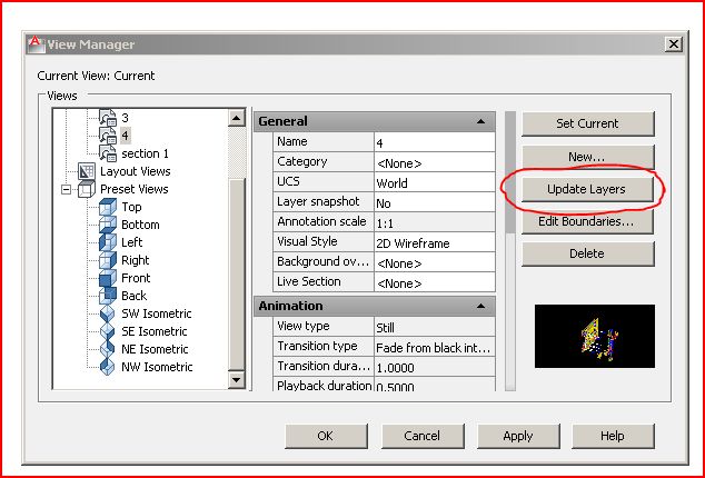

I have got a large drawing with multiple viewports and some layers that are shown in model space won't show when I access model space from paper space (through the viewport). I have had a look at the layer manager through the viewport and everything is switched on, there is no viewport freeze activated but still I can't see the lines in the viewport in paper space (either in model or paperthrough the template).

If you have designated and saved nonstandard views in your views manager, those usually have layer properties saved in them. If you check on your view manager you could turn off those saved layer visibility settings (VIEW LAYER SNAPSHOT) in any particular view where you are having this problem.
Or you can use the UPDATE button to change the layer visibility to your current settings.
