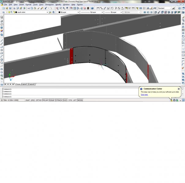

cfrydawg Posted February 12, 2012 Posted February 12, 2012 Hey guys what is the best way to flatten out a radiused peice of sheet metal with holes in it. i know how to flatshot but how do I flatten this for laser cutting and shearing Quote

kencaz Posted February 15, 2012 Posted February 15, 2012 First off, AutoCad does not flatten... You need a Parametric modeler (like Inventor), for that... Flatshot will work, however, only to get your hole distances along the radius. Then you'll have to draw the part flat... Not difficult but tedious in AutoCad... Quote
SLW210 Posted February 15, 2012 Posted February 15, 2012 (edited) I use the Arc Length on the centerline of the radius, it is usually accurate enough for manufacturing in most cases. Other than that you will need to use some formulae. Here is a pretty good site for such things SHEETMETAL GUY and CALCULATOR Some good info HERE also. Edited February 15, 2012 by SLW210 add info Quote
JD Mather Posted February 15, 2012 Posted February 15, 2012 Are the holes drilled before bending or after bending? They will be round in one form and not round in the other form. (either way) When material is bent it compresses on the inside of the bend and stretches on the outside of the bend. You can find the formula for calculating the Bend Allowance in your Machinerys' Handbook. The Bend Allowance (k-factor) is a function of the Material Thickness Bend Angle Inside Bend Radius (and to a certain extent the tooling. You can have 5 "identical" machines set up to bend the same geometry and get slightly different results from each. If tolerance is critical then a Bend Table is recorded from actual tests and kept updated over time as the machine/tooling wears). Modern 3D CAD programs like Autodesk Inventor calculate Bend Allowance either from k-factor or Bend Table as needed. As noted - a lot of sheet metal work is not particularly close tolerance so you might be able to use neutral centerline length). Quote

cfrydawg Posted February 17, 2012 Author Posted February 17, 2012 yeah it not that acurate. I guess i need to just draw it out. but im also wanting to do a radius incline witch would be even harder to lay out. I do conveyors so I need to do some complicating things sometimes. but i dont know how to make a autocad file a .ipt and flatten it that way. I have inventor Quote
SLW210 Posted February 17, 2012 Posted February 17, 2012 I designed conveyors for 10+ years using a drafting board and then AutoCAD. You just need to know the formulas. Look at the tutorials for Inventor in JD Mather's signature. Quote
JD Mather Posted February 17, 2012 Posted February 17, 2012 is there a way to make that part of the radius a .ipt file for inventor... If so what tool does it in inventor? File Open? (option Import) Convert to sheet metal. Set style Thickness. Flat Pattern. Quote

scj Posted February 19, 2012 Posted February 19, 2012 Here is an AutoCAD-solution of your problem. (please notice, that the circular holes become polygons in the unrolling process) Regards Jochen curve_ant.dwg Quote
