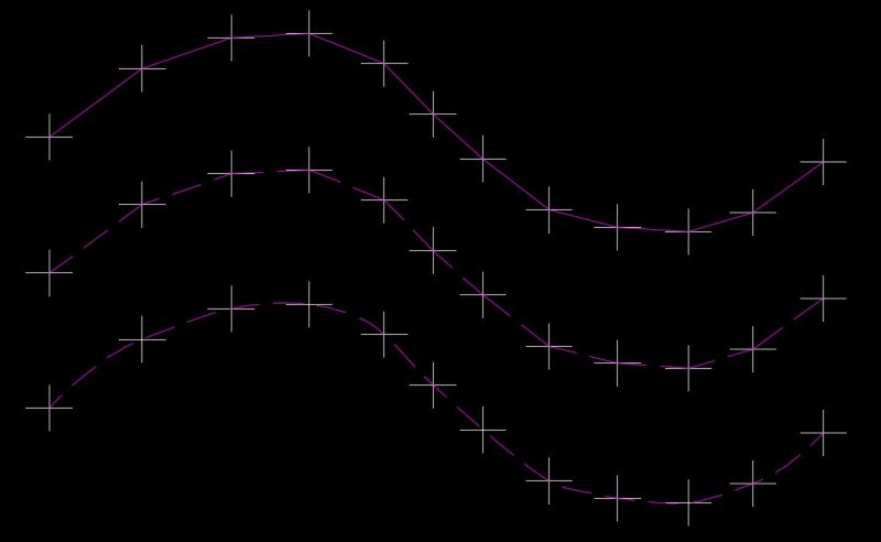

ConfusedStudent Posted February 23, 2015 Posted February 23, 2015 First, set a running OSNAP to NODE. Use the PEDIT command to establish the properties of each contour line. 1. Select each polyline, choose the Ltype option, and then choose the On option. Doing so makes the hidden linetype properties visible even if the line segment isn’t very long. 2. For all contour lines except those marking the 70-foot, 80-foot, and 90-foot intervals, also choose the Fit option for each polyline. Doing so will allow the polyline to curve between node points. Quote
Hondatek Posted February 23, 2015 Posted February 23, 2015 This is where im having problems finding how to set up. Ill work on it at home Quote
ReMark Posted February 23, 2015 Posted February 23, 2015 What do you mean by "how to set up"? Your contours are using the linetype called HIDDEN which means they should appear dashed on your screen. Your OSnap settings should have NODE enabled (for picking points). If you have drawn all your contours using a polyline and they are currently being displayed as straight line segments between points, by running the PEDIT command and selecting a polyline then the FIT option the polyline will be fitted with a curve that passes through each point. Quote
Hondatek Posted February 23, 2015 Posted February 23, 2015 REMARK i posted a screenshot. i have that set up already. OSnap settings should have NODE enabled. done this is what I don't think I did. by running the PEDIT command and selecting a polyline then the FIT option the polyline will be fitted with a curve that passes through each point. follow me? Quote
ReMark Posted February 23, 2015 Posted February 23, 2015 Top: Polyline - continuous - straight segments. Middle: Polyline - hidden - straight segments. Bottom: Polyline - hidden - Curve fitted. Quote

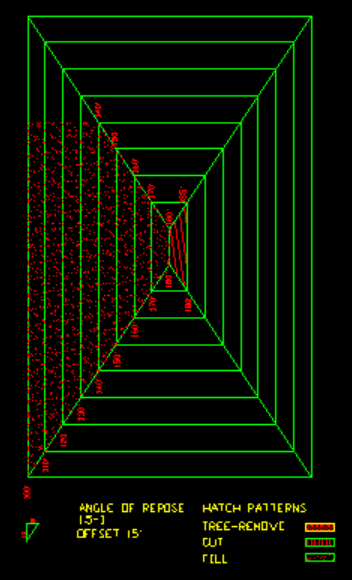

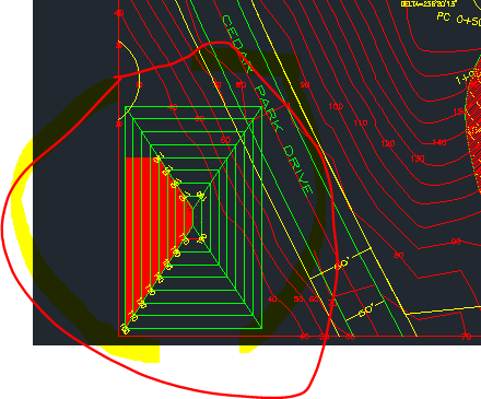

Yirlesa Posted December 11, 2020 Posted December 11, 2020 hello! i'm done with the most of thigs from the plate 2 , i was looking an example from one of the guys of this forum and still i'm no clear in how to do this ,,, i already did the cut of angle of repose with the contour but i cant figure out how to get this asked the P-F tutor some questions about how to place the foot print and do another things and he explain really good but still don't understand this if somebody here can help me out i would appreciate so much thanks Quote
ReMark Posted December 12, 2020 Posted December 12, 2020 That looks fairly close to what this student submitted. Quote
Yirlesa Posted December 13, 2020 Posted December 13, 2020 On 12/12/2020 at 11:40 AM, ReMark said: That looks fairly close to what this student submitted. Expand thanks for the reply but i don't know what is that .. im trying to figure out how he did that with base of his contour,, i just want to understand Quote
ReMark Posted December 13, 2020 Posted December 13, 2020 You mean the image that you posted previously was not from your drawing? Quote
