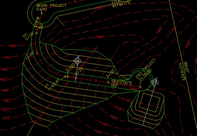

ReMark Posted September 14, 2012 Posted September 14, 2012 There is no section across the cul-de-sac although there is one across the driveway and some of the property on either side of it. The student is asked to construct a centerline profile of the driveway starting at the Ocean Avenue cul-de-sac. Quote
mamiller23352 Posted September 14, 2012 Posted September 14, 2012 how do i do that with the curves and all? Quote
mamiller23352 Posted September 14, 2012 Posted September 14, 2012 i figure it means lengthwise cause other than that it would be too small to plot out Quote
ReMark Posted September 14, 2012 Posted September 14, 2012 Treat the curves line a piece of string that you picked up and stretched out taunt. You would have to indicate the stationing for the P.C. (point of curvature) and the P.T. (point of tangency). I think they are 0+50 and 1+93.87. Quote
mamiller23352 Posted September 14, 2012 Posted September 14, 2012 ok thats making some sense to me now so the top of the driveway should basically b a straight line due to the cut and fill at an elevation of 180 and below that you show where I wouldve been had there been no cut and fill and mark it up accordingly? Quote
ReMark Posted September 14, 2012 Posted September 14, 2012 Here is where, as you pointed out, the instructions fail to provide enough information. Maybe a student like Car5858 fired off an email to the school and got a response that explained things a little better. I'm not sure though. Anyway, I think I know what you are getting at. You are going to plot both the proposed and existing grades is that what you have in mind? Quote

kamila Posted May 4, 2013 Posted May 4, 2013 ReMark said: Re: existing site plan. Some of your contours do not look correct. [ATTACH=CONFIG]32911[/ATTACH] I think the spot elevation on the far left should be 21 and not 2.1 don't you? The loop in the 120 ft. contour isn't right and the way the 130 ft. contour is formed does not appear to be correct either. hi, I am confused about units. is this one correct? I did the same way and I dont understand why the 10' in diameter BM is almost the same as 6" text? Quote
