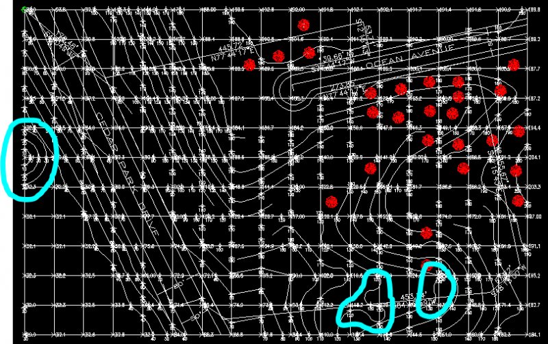

ReMark Posted February 13, 2012 Posted February 13, 2012 Re: existing site plan. Some of your contours do not look correct. I think the spot elevation on the far left should be 21 and not 2.1 don't you? The loop in the 120 ft. contour isn't right and the way the 130 ft. contour is formed does not appear to be correct either. Quote
HARPAL Posted February 13, 2012 Author Posted February 13, 2012 Hi Good morning Thanks for guidence.I have attached both dwgs. after making corrections.The 1st elevation of row 6 is 2.1(as printed in project book),but i made it as 21, I am working on plate 3 now.If you find anything wrong in my dwgs. please feel free to let me know and I would really appericiate that.I have taken off today just to try finish this assignment at earliest possible.CIVIL DRAFTING PROJECT (DRAFTING THE EXISTING SITE PLAN (PLATE-1) TO BE SUBMITTED.dwg Thanks CIVIL DRAFTING PROJECT (DRAWING THE PROPOSED DRIVEWAY AND BUILDING SITE (PLATE-2) TO BE SUBMITTE.dwgFetching info... Quote

ReMark Posted September 14, 2012 Posted September 14, 2012 A classic mistake I have seen in most student drawings done for this project is how the new contours are melded into the existing ones. Typically these are not abrupt/sharp but rounded off. It's one of those things I think the P-F instructions fail to point out (amongst many others). New contours cannot just end in the middle of nowhere either. They have to blend back into the existing contours of the same elevation. A contour is usually broken to allow for the insertion of the contour interval like this --- 170 ---. In other words the contour line does not pass through the text. There is a way, using a TextMask to get this same affect without physically breaking the contour line in AutoCAD but I don't think P-F tells the student how to accomplish this. Are we missing the section lines A-A and B-B? One should try to avoid having text sitting on top of geometry as it may make it difficult to read when the drawing is printed. Quote
