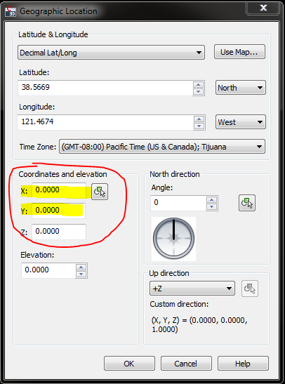

ScribbleJ Posted February 10, 2012 Posted February 10, 2012 See the image below; X and Y fields are highlighted in yellow and circled in red. Do you want to put a specific coordinate system projection on the file instead? Quote

ScribbleJ Posted February 10, 2012 Posted February 10, 2012 Scribble, you are correct, however, I don't believe this function is available in vanillaCAD, which OP has listed in 'using'. Ahh ok. Could be. I do not have vanilla AutoCad. The very least we use here is the Map 3D version so I cannot test this. However when I do a search in the help file and filter it to just AutoCad commands it does come up in the search. Edit: I found a PC with vanilla AutoCad on it here and this command is available. At least in the 2011 version. Quote
khoshravan Posted February 11, 2012 Author Posted February 11, 2012 See the image below; X and Y fields are highlighted in yellow and circled in red. Do you want to put a specific coordinate system projection on the file instead? [ATTACH=CONFIG]32865[/ATTACH] I am using AutoCAD 2077 and 2010. In 2007, the box is not like as you posted. I haven't checked 2010 yet. Bill: Your solution sounds good. I will download US Corps add in. thanks Quote
