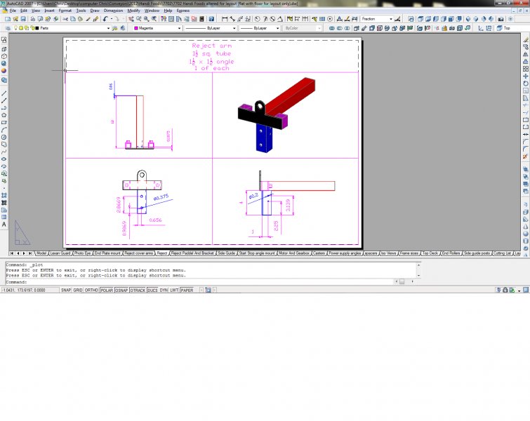

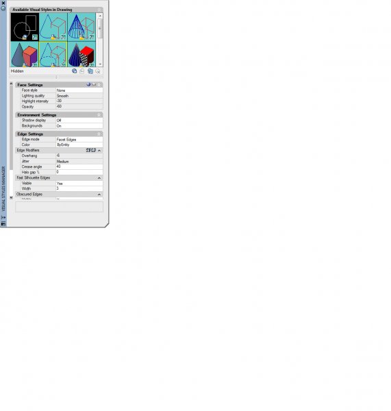

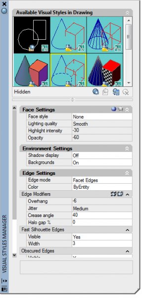

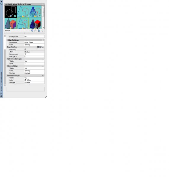

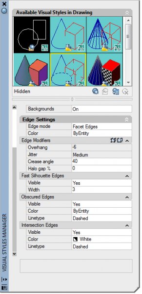

cfrydawg Posted February 10, 2012 Posted February 10, 2012 (edited) Hey guys, First post here, I have a huge problem that takes up sooooo much time when im laying out a drawing. I use a visual style with facet edges and occluded edges dashed and intersection edges dashed. To give my lines hidden fo fabricators to know witch way to face angle iron and so on. But here is the big problem i do a veiw port with 4 shots 1 isometric solid 1 top hidden lines front hidden lines and right hidden lines. so first time i plot it, it will work fine then i go back to plot then the lines ither become not shown at all or they will be solid. even know the veiwport still shows them as hidden lines. this drives me nuts any ideas? oh and if I delete the veiwport and make a new veiport all over again it will work for a single print then will not show it all over again. Edited February 10, 2012 by cfrydawg missed info Quote

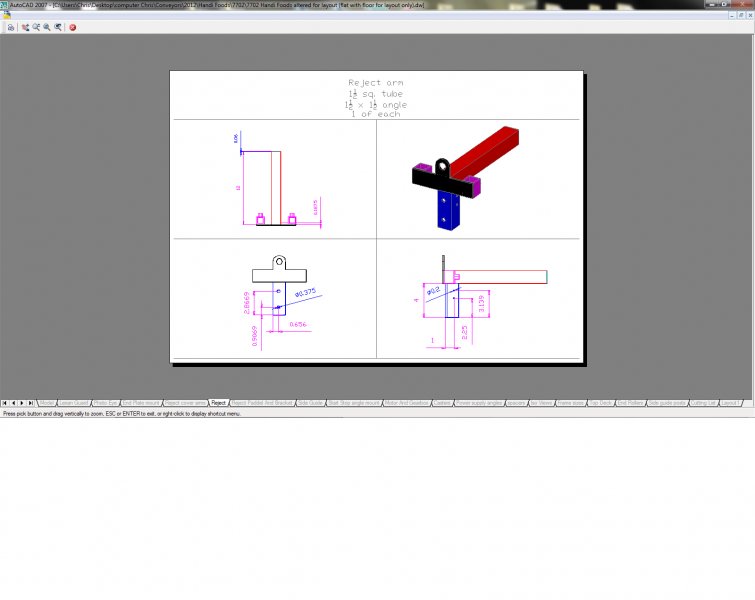

cfrydawg Posted February 12, 2012 Author Posted February 12, 2012 (edited) Can you post an example drawing and some screen shots of your plot settings? Are you plotting to a plotter or PDF etc.? IM just printing on a regular printer letter size i select while printing. the top pic shows what my screen should print, but when i print it (bottom pic)it drops the hidden lines and not even showing lines at all. Edited February 12, 2012 by cfrydawg missed info Quote

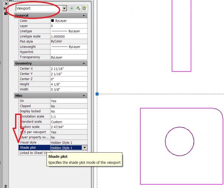

nestly Posted February 12, 2012 Posted February 12, 2012 I have experienced problems in the past with 2011 when trying to plot layouts that have viewports with different visual styles. Make sure the "Shade Plot" properties for each viewport is manually assigned, not set to "As Displayed" If you can't make it work, you might consider using FLATSHOT or VIEWBASE to create your projected views. You said in your other post you were using AutoCAD2007, which I don't have, but I created a new VS in 2012 that matches yours, and the Plot Preview displays correctly. Quote

nestly Posted February 12, 2012 Posted February 12, 2012 Where can i find shade plot cannot find it On the Properties Palette for each Viewport, near the bottom under Misc. Quote
cfrydawg Posted February 12, 2012 Author Posted February 12, 2012 I must be crazy i cannot find it Quote
nestly Posted February 12, 2012 Posted February 12, 2012 Open your Propertied Palette, Switch to Paperspace, and click a viewport.... unless 2007 doesn't have that property? Quote
