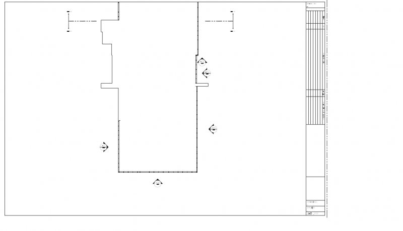

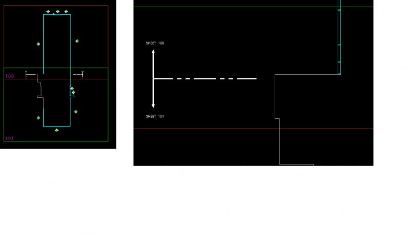

Jack_O'neill Posted February 11, 2012 Posted February 11, 2012 apologies for the first thread. I was worried about repeating a question that was already posted. anyway, the match line is applicable in layout only, yes? could anyone explain to main function of this match line?does it actually allow me to combine 2 separate drawing files, at the already existing match lines in both drawings? *could not find much info on the match line topic. Thnx for the quick replies! What a matchline is for is to simply know where the overlap is if you have to split a drawing onto more than one page. In the image below, what you see on the left is a screen shot of what I call a keyplan. This shows the locations of curtainwall elevations on a very general outline of the building. On the right is a zoomed up view of the matchline. It tells you that anything above is on sheet 100, anything below is on sheet 101. When pubished to pdf (or printed on paper) sheet 101 looks like this: Quote
