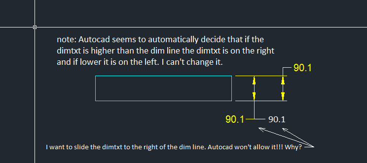

mattloops Posted February 9, 2012 Share Posted February 9, 2012 (edited) When dimensionning linear dims using leaders, I can't get the dimtxt to slide from one side of the dim line to the other. The dimtxt only switches side if I place the dimtxt on top or below the dim line. Very weird. Can you help on how to work around this. Please see flickr picture link for a better idea of what I mean. Thanks Edited February 9, 2012 by SLW210 Quote Link to comment Share on other sites More sharing options...

mattloops Posted February 9, 2012 Author Share Posted February 9, 2012 Can you see this? That was my initial photo link. Quote Link to comment Share on other sites More sharing options...
ReMark Posted February 9, 2012 Share Posted February 9, 2012 You have four choices listed under Text position horizontal. That's all AutoCAD allows. Quote Link to comment Share on other sites More sharing options...

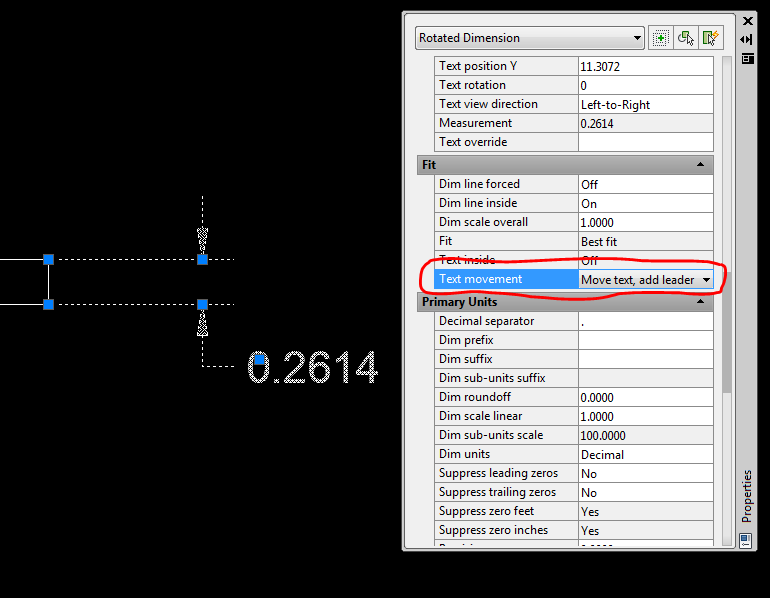

ReMark Posted February 9, 2012 Share Posted February 9, 2012 OK...I found a way to get the text over to the other side. Quote Link to comment Share on other sites More sharing options...
mattloops Posted February 9, 2012 Author Share Posted February 9, 2012 Thank you ReMark. This works for me, for now. But it is not an optimal solution. If you notice when you pull the dimtxt farther away from the dim line (on the other side) the leader changes and is no longer at 90 degree angle. It seems like having a long leader line at 90 degrees on either side of the dim line is not feasable in Autocad. Thanks again for your prompt answer to my question - Quote Link to comment Share on other sites More sharing options...
ReMark Posted February 9, 2012 Share Posted February 9, 2012 I got it at a ninety degree angle (verified by the image above) and so can you. And don't expect me to post a movie about how to do it cause my last name ain't Spielberg. LOL Quote Link to comment Share on other sites More sharing options...
mattloops Posted February 9, 2012 Author Share Posted February 9, 2012 Yes it's at 90 degrees and I got that too. What I'm saying is that you can't extend the leader line much longer that what you're showing me on your post. The leader line will switch to an angled attachment line. Anyways, I think you know what I meant. No need for a movie. Thanks again. Quote Link to comment Share on other sites More sharing options...
