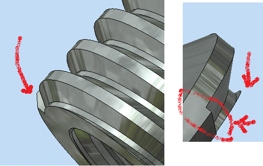

Thread.pngFirst thing I would do is fix the thread before worrying about animations.
  JD Mather said:
[ATTACH=CONFIG]32748[/ATTACH]First thing I would do is fix the thread before worrying about animations.
Hi JD,
Here is the modified threaded screw. This is the best that I can think of doing it.
