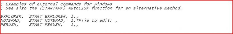

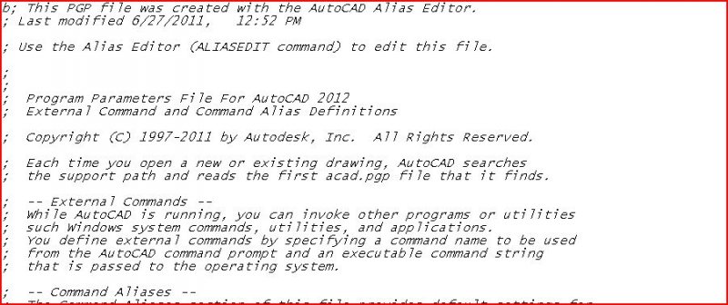

You can open other programs from within autocad, by setting up new shortcalls in your .pgp file. Click TOOLS > Customize > Edit Program Parameters. I believe you could do it this way, although there is no doubt another way to do it. I have notepad set to open with NN, so in the middle of a drawing it is easy for me to make a note, should I find an issue, which is saved to a folder on my desktop.
