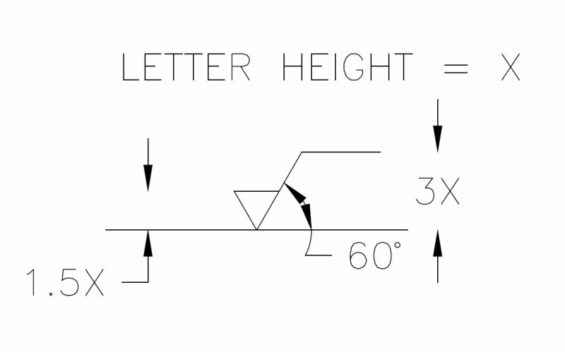

You may just have to create the symbol yourself if you cannot find a font that incorporates it as a special character.
Like this draw the symbol and save it is a block.
There are symbol standards in ASME Y14.36M
I submitted this as a jpeg because I am a student using an
AutoCAD Educational Product.
when setting up your profile, set the gdt.shx font as default. All the lower case letters are symbols.
I would not expect the OP to have a problem drawing the symbol and creating a block.
There is a long list od GDT symbols within the mtext editor itself. Check out the top of your screen while you have the text editor open. You will see the @ symbol, click that and select other, then type in GDT.
The surface symbol is not included in GDT.
Make a block or, does anyone know how (?), add it to the GDT symbols?
I would create a block with attributes.
