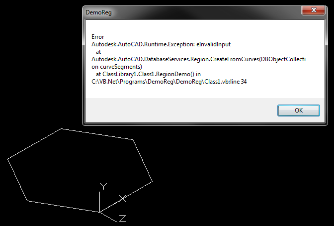

Hi
when the item is generated in WCS all is file
If the UCS is changed then Error As Below:
what i have picked up is that i have not transformed the points to the new User UCS.
in progress
Any ideas most welcome

Oops. I forgot to transform the initial point. This should provide a better match with the current UCS origin.

Hi There
Thanks a lot for the assistance
My code functioning to what was desired.
"Dim Line1 As Line= DrawLine(Initial, 0.0, 100, MatToUcs)"
Your method excellent as highlited above - keeps code simple
