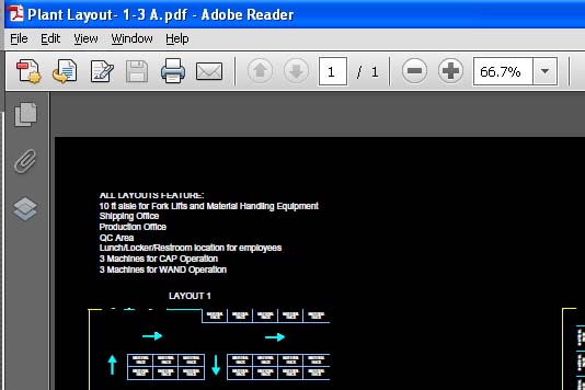

Perhaps with more application to Googling, you would have seen this, which does what you want. You make the PDF from AutoCAD in the normal way, but Adobe Reader can reverse the colours.
You still have not confirmed that you are using a Black background in AutoCAD, but from your comments, we can assume it is so.
Here is a screen shot of such a file in Adobe Reader. You can turn all lines to white, or just the text.

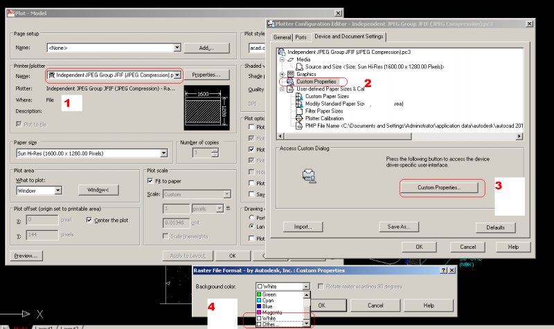

Alright guys...I think I found a way around this. First of all, you'll need to plot your drawing to either a jpg or png using one of these plotters:
Then follow these 4 steps to create the file, with any background color you wish:
This will work with either png or jpg files. You then insert that file into your pdf with photoshop or word or whatever you use.
This method created this image:
It's a few extra steps, but it will get you where you want to go. Make the image larger than you need and shrink it down. That will look much better than trying to stretch a small image.
AHHHH THANK YOU ELDON! THIS WORKED! THANK YOU!! As promised...
Eldon, you are the smartest person I know! ;)
