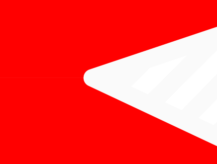

Jack_O'neill Posted February 2, 2012 Posted February 2, 2012 Clipped from the help files in 2010: ACI colors are the standard colors used in AutoCAD. Each color is identified by an ACI number, an integer from 1 through 255. Standard color names are available only for colors 1 through 7. The colors are assigned as follows: 1 Red, 2 Yellow, 3 Green, 4 Cyan, 5 Blue, 6 Magenta, 7 White/Black. If you notice, it lists color 7 as White/Black. This is a hold over from the old days when you had a black screen or a white one. This color would display as white on a black screen, and black on a white screen so you could see what you were doing. After re-reading this I see that the OP is trying to get this to happen in a PDF file...I thought he was trying to send it to a printer. You can set what ever you want to color 255 which is a very pale gray, almost white, but you will get a gray line when it sends to the PDF at the very best. It will be so faint though, that you'll not be able to see it. It will however show up in the print preview as a fairly distinct gray. Don't trust the print preview to show exactly how it will turn out. The pic below is the corner of a triangle drawn and solid hatched in color 255 surrounded by a red background and zoomed at 3200% in Adobe Reader X. I did it originally without the red background and could not find the triangle on the page. Quote
