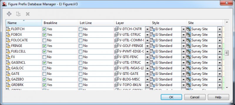

In C3D, you declare certain Figure Codes to be Breaklines in the Figure Prefix Library. Then once you "Import Survey Data", you can right-click on the Figures (on the Survey tab of Toolspace) and create breaklines. Every Figure Code that is flagged as a Breakline gets added to the Surface. This is something shown in that Survey F2F demo I posted recently.

That's not the typical way of using C3D's built-in F2F functionality... With that, the breaklines are defined in the Figure Prefix Library:

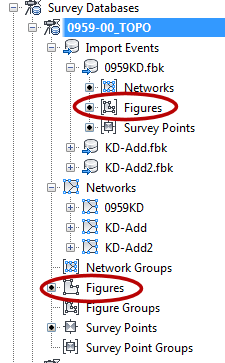

Note how "Breakline" is selected for some codes, and not for others. Then on the Survey tab in Toolspace, you can select on one of the Figure collections and right-click, then use "Create Breaklines..."
The difference is that if you select the one in the Import Event, you'll only add Figures from that Import Event. The lower one will add ALL figures that are flagged as Breaklines, even if you import the data in different Import Events.
