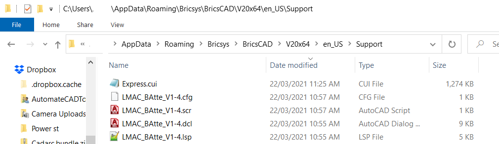

Flip Flop Posted March 18, 2021 Posted March 18, 2021 (edited) This looks really useful but relies on the creation of .SCR files which, on our corporate locked-down laptops, is forbidden. Is there any way of removing the dependency on .SCR files? Or is there any way of getting AutoCAD to run a script saved as a .TXT file? Thanks Edited March 18, 2021 by Flip Flop Quote
Lee Mac Posted March 21, 2021 Author Posted March 21, 2021 Unfortunately the AutoCAD SCRIPT command will only accept .scr files, and I'm not aware of a way to circumvent this restriction. The program could be written to update attribute values using ObjectDBX (similar to my old Global Attribute Editor), but this introduces a host of other issues such as misalignment for non-left justified attributes, restrictions on save format, and missing drawing thumbnails - consequently, I opted to abandon the use of ObjectDBX when developing this application. Quote

BIGAL Posted March 22, 2021 Posted March 22, 2021 (edited) My question is that maybe its where Lee is writing all the files this may be in a restricted directory. For flip flop, a simple test a script file try to open 2 dwgs. Just put full path and dwg name eg c:\\mydwgs\\myprojects\\dwg1 Open dwg1 Open dwg2 If successful Lee may be watching, maybe use the vl-filename-mktemp rather than \USER......... need Flip Flop to confirm. Note Appdata is hidden suggesting higher admin level of control. Edited March 22, 2021 by BIGAL Quote

BIGAL Posted March 22, 2021 Posted March 22, 2021 If you look at what I posted you can get at the location and the file name. So add c:\users\......\LMAC_BAtte_V1-4.scr to whitelist. Give that a try. 1 Quote
