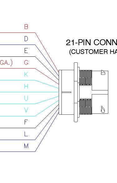

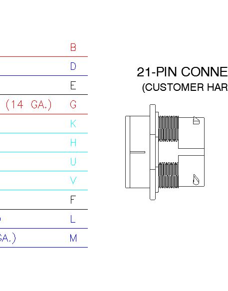

bgietzen Posted January 26, 2012 Posted January 26, 2012 My question is how do i extend lines to a specific point? I have attached a before and after image below for an example. But obviously it takes to long to do this line by line and getting the spacing correct. Is there a way to do this? Quote

rkent Posted January 26, 2012 Posted January 26, 2012 After you have the horizontal lines, copy all of them end to end so you have two lines on each row, joining end to end. Turn Ortho off, use the change command, select all the lines on the right hand side, pick the endpoint of the center line, or to any point you choose. They will now converge to a single point, stretch them or move your block, then trim them to the edge of the block. It is quicker to do it than it is to describe. Quote

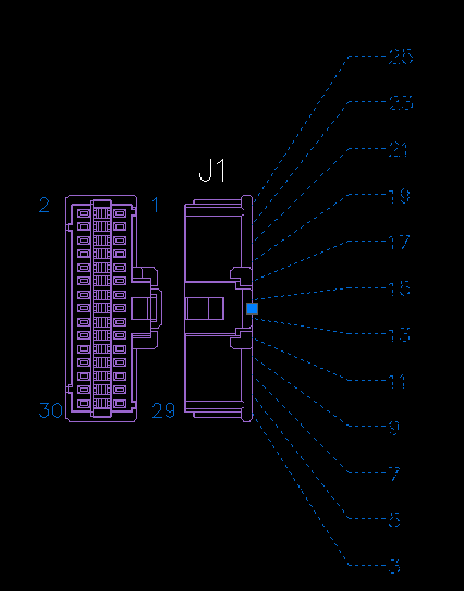

Jack_O'neill Posted January 26, 2012 Posted January 26, 2012 block example.dwgThis is what I had in mind: The blue lines and text are a block, and you can see it's insertion point (the grip). If you have it bring it in exploded, then all you'd have to do is edit the text. You could do one of these for each type of cable you use, or put them all in a dynamic block, or group them up some way that would make sense to you. Actual drawing file is attached if you want to play around with it. Quote

bgietzen Posted January 26, 2012 Author Posted January 26, 2012 Not sure how to do that. how do i divide the vertical line? Then how do i snap I am willing to do one line at a time but the problem with that is the time it takes the picture at the top of this thread shows the before and after. I manually had to draw each line from the horizontal lines with the #'s on it to the vertical line (connector) this example is one of the smaller sets I have to do. Quote

Jack_O'neill Posted January 26, 2012 Posted January 26, 2012 Unless you just want to though, using rkent's method makes dividing the vertical line unnecessary. It will take the endpoints of the horizontal line to the midpoint of that line in back, then you simply trim them off. They will be proportionally spaced with no other effort required. Quote
bgietzen Posted January 26, 2012 Author Posted January 26, 2012 EXACTLY - That is perfect. Thanks a million rkent. never used "CHANGE" command before. Quote
