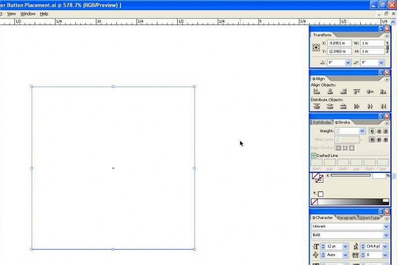

I'm a little embarrassed to ask this but, as I've said in my title, Illustrator is recognizing my stroke weight and aligns to stroke instead of the path. It somehow defaulted to this without me doing anything. How do I convert it back?
Again, embarrassed because I've been working with Illustrator for 12 years.

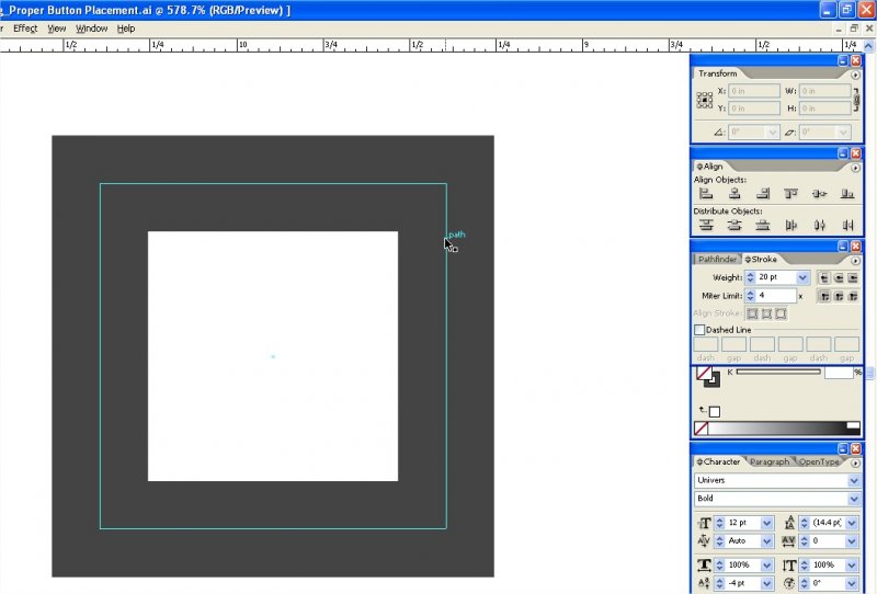

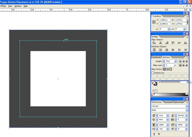

I've got the answer for all who are interested but I'd like to give props to the guy that gave it to me. He has his own Adobe Illustrator website and I'd like to thank him for his answer by posting his URL on the forum. Will this be okay with the Moderators?
Answer from Ryan Putnam of www.vectips.com:
Under General Preferences make sure you have "Use Preview Bounds" unchecked. This can be a handy little setting for some uses, but not if you want to use an object's path for transforming, aligning, and so on.
