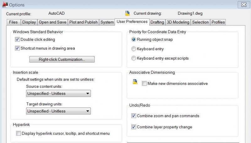

ReMark Posted January 19, 2012 Posted January 19, 2012 It might help too if your dimensions were associative which is not the same as annotative. And don't forget to use your OSnaps. I always dimension in my paperspace layout. Quote
rkent Posted January 19, 2012 Posted January 19, 2012 Set DIMASSOC to 2, Do Not change DIMLFAC. Quote

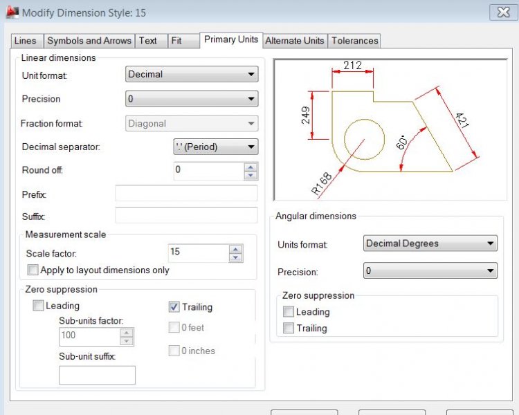

ScribbleJ Posted January 19, 2012 Posted January 19, 2012 Another way to use dimensions in paper space (Layout) is to change the scale factor in the Primary Units tab within the Dim Styles dialog. For 1/4" = 1'-0" set the scale factor to 48. Quote
twrfte Posted January 20, 2012 Author Posted January 20, 2012 (edited) Grant: dimlfac=24 *does* give the correct dimensional values for my scale. are there downsides to using dimlfac? Edited January 20, 2012 by twrfte Quote
twrfte Posted January 20, 2012 Author Posted January 20, 2012 ReMark: how do i make the property associative? the box in Properties is grayed out. I am glad you have successful using paperspace for dimensions -- i am really hoping to clean up my model views. Quote
twrfte Posted January 20, 2012 Author Posted January 20, 2012 rkent: my dimassoc is -- and has always been -- set to '2'. Why not change dimlfac? Quote
twrfte Posted January 20, 2012 Author Posted January 20, 2012 ScribbleJ: I believe that is the same as DIMLFAC. Evidenced by the fact that when i changed the DIMLFAC variable the value in the Dim Styles dialog was updated with the same value. Quote

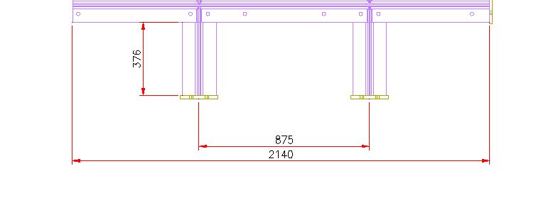

Dadgad Posted January 21, 2012 Posted January 21, 2012 I dimension in paperspace exclusively, and as shown in the attachment, I have no difficulty dimensioning in paperspace. The xref has been attached in MODELSPACE, it is a unitless block. Quote
