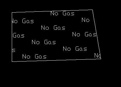

ReMark Posted January 18, 2012 Posted January 18, 2012 (edited) Jumping jack flash it's a gas. Be more specific? Sure. 1. Make a block that uses the text NO GAS. 2. Use the SUPERHATCH command to populate an area of your drawing with the block. See above. Edited January 18, 2012 by ReMark Quote

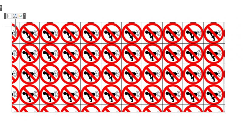

Murph_map Posted January 19, 2012 Posted January 19, 2012 Or if you want symbols instead of text. Quote

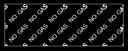

hugha Posted January 19, 2012 Posted January 19, 2012 (edited) Can't beat that. Attached is from HatchKit, NOGAS.PAT with text height = 100 hth Hugh Adamson Cadro Pty Ltd www.cadro.com.au www.hatchkit.com.au Nogas.zip Edited January 19, 2012 by hugha Quote
MRAKA Posted January 19, 2012 Author Posted January 19, 2012 Hugha your a legend. Andrew UK Wales Quote
