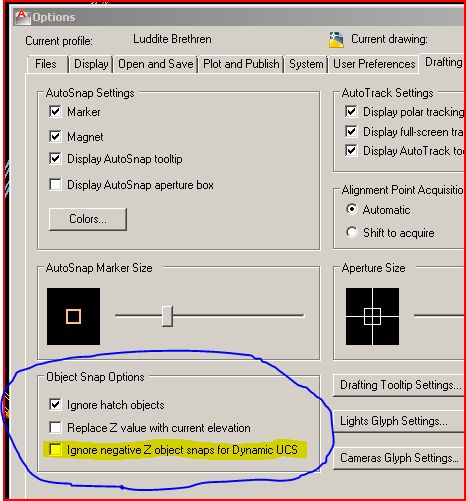

AlexNeale Posted January 16, 2012 Posted January 16, 2012 Hi guys, I was hoping one of you might be able to help me. I am working on Autocad 2012, and am having a problem drawing on faces under another face, whilst working on 3d objects. I have the view set to 2d wireframe, and can select objects underneath whilst not drawing/modifying anything, however as soon as i try to draw it just selects the uppermost face to draw on. Is there a button to allow me to snap to different layers whilst drawing? Thanks! Quote

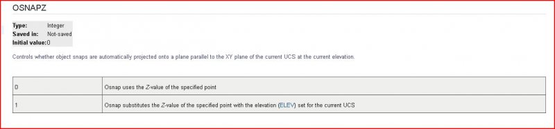

Dadgad Posted January 16, 2012 Posted January 16, 2012 Type OPTIONS at the commandline > ENTER in your OPTIONS DIALOG BOX select the DRAFTING tab, and check your object snap options. Compare the settings of one of your coworkers with your own. I believe that you may have the yellow highlighted option checked, and that unchecking it may solve your problem, enabling you to snap to negative z values. OSNAPZ has two settings, I believe the value you want is 0. Quote
AlexNeale Posted January 16, 2012 Author Posted January 16, 2012 Dadgad you're an absolute star! Worked a dream. Thanks buddy! Quote
