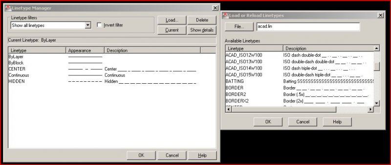

Dadgad Posted January 16, 2012 Posted January 16, 2012 You can apply whatever linetype you choose to a polyline. After creating a polyline you can alter the linetype in the PROPERTIES dialog box. If you type LTYPE in your commandline, it will open the linetype manager. If you click on LOAD, you will see the library of available linetypes in the program. Quote

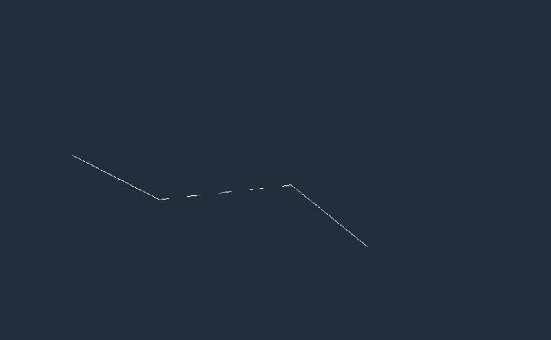

Loque Posted January 16, 2012 Author Posted January 16, 2012 So, I would create let's say 3 plines, and then I would like to edit one of them(let's say the middle one) to be dashed. (coz this line represent some kind of a road symbol) something like this. so, basically I want to edit just one segment of the line to be different line type but one line (when I press ctrl + 1 it would display the length of the line/pline) Quote

eldon Posted January 16, 2012 Posted January 16, 2012 So, is it possible to create one polyline that has combined dashed and continuous type of line in one polyline? It is possible with a bit of work, by using the fact that short lengths of dashed line are continuous, and disabling the linetype generation. The picture shows the (apparently) continuous lines are actually short lengths (shown by the grips) but it is all one polyline. Quote
Loque Posted January 16, 2012 Author Posted January 16, 2012 It is possible with a bit of work, by using the fact that short lengths of dashed line are continuous, and disabling the linetype generation. Can u pls explain? Quote
Tiger Posted January 16, 2012 Posted January 16, 2012 Look at Eldons image - every blue square is a vertex on the polyline, when you draw the line, you have to click at every one of the blue spots to acheive your result. With all respect to Eldon, it doesn't look like a particular good solution though - scaleing in the Viewport for one thing will mess with the result to no end... Quote
