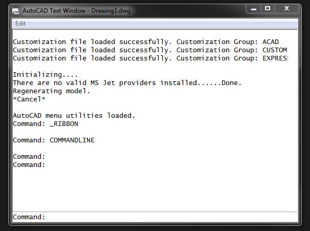

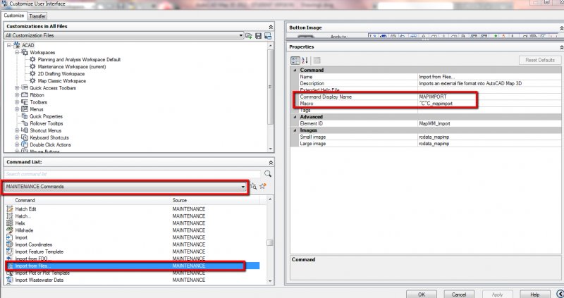

Alistair Posted January 13, 2012 Share Posted January 13, 2012 Hello, I'm using Map 3d 2012 and trying to insert a shortcut icon(panel) into the INSERT tab on the UI Ribbon for the _MAPIMPORT function. I can't find the function in the list of commands, but the function is available if I type it into the command bar. Can anybody point me in the right direction? Many thanks for any help. Quote Link to comment Share on other sites More sharing options...
Murph_map Posted January 13, 2012 Share Posted January 13, 2012 In 2012 it's under the Maintenance commands section and is labled as "import from files". Quote Link to comment Share on other sites More sharing options...
Alistair Posted January 18, 2012 Author Share Posted January 18, 2012 Hi Murph, Thanks for your reply. I can't find the Maintenance commands section, could you point me in the right direction. Also, can you tell me how to keep the Express Tools tab permanently on the Ribbon? Many thanks for any help you can give me. Alistair. Quote Link to comment Share on other sites More sharing options...
Murph_map Posted January 18, 2012 Share Posted January 18, 2012 In the CUI editor. see attached Quote Link to comment Share on other sites More sharing options...

Murph_map Posted January 18, 2012 Share Posted January 18, 2012 The screen shot is from a 2012 version of MAP3D, when you start Map3D right after it loads use press the F2 key, look for any thing like Customized file loaded unsuccessfully. If there's one or more you may need to try a repair install. Quote Link to comment Share on other sites More sharing options...
Alistair Posted January 18, 2012 Author Share Posted January 18, 2012 I've restarted AutoCAD and pressed F12. ACAD, CUSTOM and EXPRESS all say they've loaded successfully. An image is shown below. I'd be greatful for any further help you can give me. Quote Link to comment Share on other sites More sharing options...
Murph_map Posted January 18, 2012 Share Posted January 18, 2012 Are you using AutoCAD MAP3D or just AutoCAD. That image shows you are not loading any of the MAP3D files. If you are using MAP3D you should try the repair from the windows control panel. Quote Link to comment Share on other sites More sharing options...
