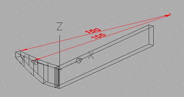

stenews Posted January 12, 2012 Posted January 12, 2012 Hi guys, what I need to do is to flatten a spline into a pline because I need to measure its diameter. I know how to it with a 2d spline but how can I manage in case I have a 3d one? thanks a lot, Stefano P.S. for some unknown reason I can't attach my draw any more Quote

stenews Posted January 13, 2012 Author Posted January 13, 2012 watch out the draw, explode it and try to convert the splines into a poli lines Quote
ReMark Posted January 13, 2012 Posted January 13, 2012 Is this what you wanted? Helix Z at Zero.dwg Quote
stenews Posted January 13, 2012 Author Posted January 13, 2012 well...not really, I just need to have a measure of the diameter of the rounded part of that helix steps Quote
ReMark Posted January 13, 2012 Posted January 13, 2012 I guess I assumed that since you specifically mentioned you needed to have a 3Dspline flatten that you were working with a 3Dspline and not a solid. When I did my test of the lisp routine found here at CADTutor I used a 3Dspline and it did indeed flatten. Quote
ReMark Posted January 13, 2012 Posted January 13, 2012 The radius is 155. The length of the outermost arc would be 48.6947. Quote
eldon Posted January 13, 2012 Posted January 13, 2012 Am I being too simplistic about this? The aligned dimension (of the radius) is from the Centre of the arc to Perpendicular to the arc, using the drawing as is. Quote
stenews Posted January 13, 2012 Author Posted January 13, 2012 okay...you're nearly got it and now what about the radius of the lower part? I mean the one that is underneath the 155 radius? P.S. I'm so sorry...I really did a terrible explanation Quote
ReMark Posted January 13, 2012 Posted January 13, 2012 The wall is the same width throughout its height. Shouldn't the radius remain the same? Quote
stenews Posted January 13, 2012 Author Posted January 13, 2012 have a look at this draw. My CNC machine needs to know the radius of the surface that I used to slice the step underneath the tread of this step. And it's a spline when I try to explode it.... helix_step.dwg Quote
