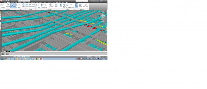

Ste1978 Posted January 12, 2012 Posted January 12, 2012 Hi all, I have not really used Autocad 3D much although I do use Inventor quite a bit. I have a simple question for you, how can I take simple measurements from the pipes on the image? Diameter, radius of bends etc? Is there a tutuorial anywhere regarding taking measurements? I realise I can export the pipe into Inventor and do it that way but I would rather learn how this is done in CAD. Any ideas? Quote

Ste1978 Posted January 14, 2012 Author Posted January 14, 2012 bill_borec said: I'm not entirely sure I understand what you are trying to do...However, vanilla AutoCAD has a distance command (DI) and object snaps (OSNAP such as QUA, CEN, END, MID, etc.) that can be used to quickly give the user information regarding distances. Additionally, the attributes or listing the element will often provide information about the object (diameter, length, radius) depending on how the object was created. Hope this helps. If not, I probably did not understand. Good luck! List does not seem to give me the diameter??? The ID command is good for the lengths etc... _MEASUREGEOM seems to be the command I am looking for! Helps if you enter 3D Workspace! Doh! Quote

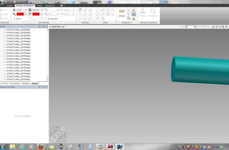

Ste1978 Posted January 14, 2012 Author Posted January 14, 2012 See here, when I select to measure radius of 3D object, I can't seem to select the circ. of the 3D pipe, it's like it's breaking this down into sections, see pic.... EDIT: Navisworks freedom also doesn't seem to grasp measuring the diameter either.... Quote

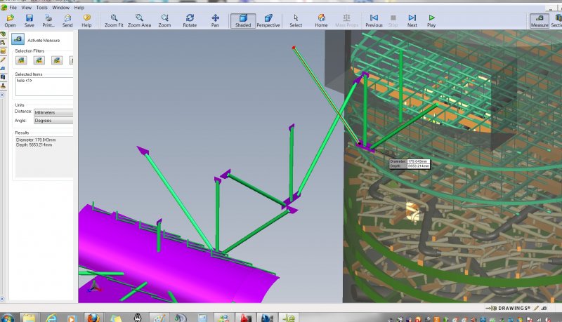

Ste1978 Posted January 14, 2012 Author Posted January 14, 2012 See how easy this is in edrawings..... You just select the pipe and voila! Quote

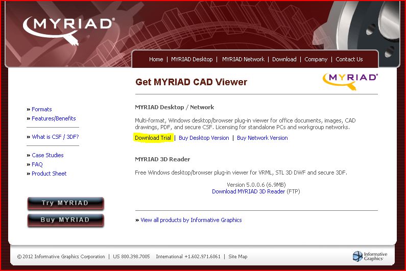

ReMark Posted January 14, 2012 Posted January 14, 2012 Myriad Viewer by Informative Graphics. http://www.myriadviewer.com/CADviewer/DWG-viewer.htm It has a 3D Measure feature. Quote
Dadgad Posted January 14, 2012 Posted January 14, 2012 ReMark said: Myriad Viewer by Informative Graphics. http://www.myriadviewer.com/CADviewer/DWG-viewer.htm It has a 3D Measure feature. There is a downloadable free trial on the purchase page. Quote
Ste1978 Posted January 15, 2012 Author Posted January 15, 2012 (edited) I did try Myriad but the program will not open my dwg file, it just hangs and then crashes Can't for the life of me see why Autocad cannot include 3D measure for Dia/rad in their free viewer! Edited January 15, 2012 by Ste1978 Quote
