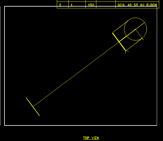

farfalu Posted January 11, 2012 Posted January 11, 2012 I am currently using Autocad Mep 2012 with Quickpen Pipedesigner add-on. Normally the Quickpen add-on automatically creates a viewport in paperspace, then I make a new viewport to show a diffent view of the piping item I am dealing with. For some reason now when I go to create a new viewport in paperspace my drawing does not show up in it. I create a viewport by opening the new viewports tab and selecting single. It seems to work fine with other drawings but all of the sudden it doesn't want to work. Any help would be great Thanks Quote

farfalu Posted January 12, 2012 Author Posted January 12, 2012 Thanks for your advice. I don't think its a zooming problem. I played around with different things and I found that if I change the layer that the piping item is on then it will show up in the viewport. If I select the piping item inside the VP that comes in automatically and change the layer you can see it disappear and reappear as I switch layers back and forth. It is only the one layer that seems to be a problem. Maybe the layer is corrupted? Quote

farfalu Posted January 13, 2012 Author Posted January 13, 2012 Here is the drawing that I have been having trouble with. Let me know if anyone can figure it out. Thanks GAS-00002-messed up copy.dwg Quote

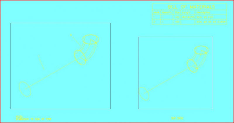

ReMark Posted January 13, 2012 Posted January 13, 2012 Proxy objects...yuk. I was going through all the trouble to download an enabler. This is the best I can do at the moment. Quote
Dadgad Posted January 13, 2012 Posted January 13, 2012 [ATTACH=CONFIG]32269[/ATTACH]Proxy objects...yuk. I was going through all the trouble to download an enabler. This is the best I can do at the moment. I'll drink to that! But both viewports are now displaying. L-gas was viewport frozen in the right viewport. You needed to click into the viewport to check it. I like to go to the layer properties manager, because you can see so much more there. Be careful when you are selecting the new layer button, because right next to it is the new layer viewport frozen button. Yeah, proxy objects ....... annoying! Quote
ReMark Posted January 13, 2012 Posted January 13, 2012 I noticed that the viewport for the top view was not created on the viewport layer which someone did go through the trouble of creating (thumbs up on that decision). Quote
Dadgad Posted January 13, 2012 Posted January 13, 2012 I noticed that the viewport for the top view was not created on the viewport layer which someone did go through the trouble of creating (thumbs up on that decision). Right, the DIM layer if I am not mistaken. Quote
