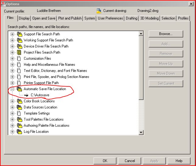

If you cannot find your .bak file then perhaps your system crashed and there should be another version.
Check in your file options, to determine where your autosave files go.
Then look in that location, it may be your TEMP files. You may get lucky.
It won't be a .bak file. Change the file type to.dwg and open it. It will likely need recovery.
