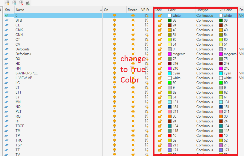

Dien nguyen Posted March 3, 2024 Posted March 3, 2024 I used this lisp to convert the color of the object to true color. Now I'm looking for a way to change the color of all layers from RGB to TrueColor. I consulted Lee-Mac's website but I still don't know how to use it. Please help. Quote
