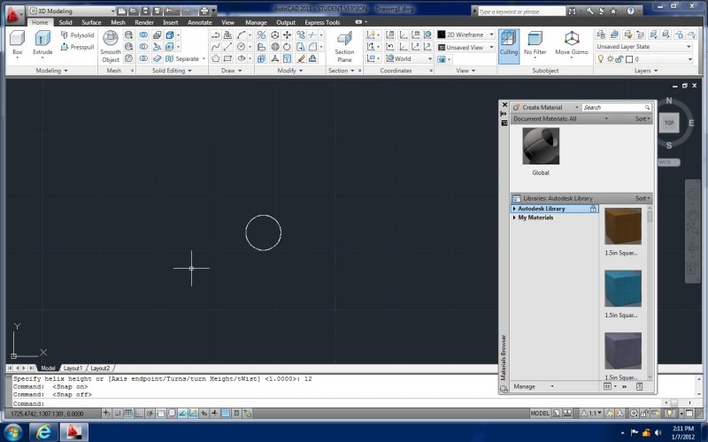

autocat Posted January 7, 2012 Author Posted January 7, 2012 I'm sorry for the late reply. I have followed your steps and i think i only see a circle Quote
Dadgad Posted January 7, 2012 Posted January 7, 2012 autocat said: [ATTACH=CONFIG]32118[/ATTACH] I'm sorry for the late reply. I have followed your steps and i think i only see a circle You should go into a different perspective view, say isometric, as what you see is not always what you get. You may have gotten it right, just hard to tell from top view. Or you can use the ORBIT command to go into your 3D modelspace and take a little look around. I just noticed you've got the viewcube displaying up in the right hand corner, go ahead and click on one of the corners and take a look. Quote
autocat Posted January 7, 2012 Author Posted January 7, 2012 yea i see a spring now.. Thanks Dadgad for the tip.. Quote
