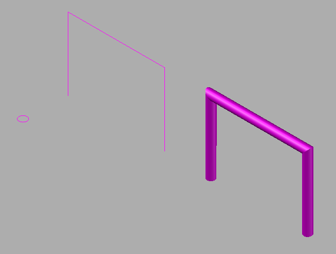

ReMark Posted January 3, 2012 Posted January 3, 2012 Another option would be to create a centerline profile and sweep a circle along it. That will give you the same effect. Quote
JD Mather Posted January 3, 2012 Posted January 3, 2012 See this tutorial (it was written for 2007, but the process is still the same - only the interface has changed). http://home.pct.edu/~jmather/content/DSG322/Inventor%20Tutorials/Inventor%2011%20Tutorial%207.pdf If you run into trouble with the Sweep that ReMark suggested or the Slice that Tiger suggested - attach the dwg file of what you are able to complete and someone will help you get the rest of the way. Quote
ReMark Posted January 3, 2012 Posted January 3, 2012 Centerline profile and sweep method. No slicing, dicing or mincing. Quote
Tiger Posted January 3, 2012 Posted January 3, 2012 ReMark said: [ATTACH=CONFIG]32020[/ATTACH]Centerline profile and sweep method. No slicing, dicing or mincing. I bow to the overlord that is The Terminator :bow: Quote
JD Mather Posted January 3, 2012 Posted January 3, 2012 ReMark said: No slicing, I don't believe it. Attach the file here. In the real world that is a weldment of 3 parts. How are you getting 3 solids without Slice after Sweep? Also, your image shows a single circle. How are you creating tube as shown in OP? (and as real world) Not mincing this up, but by the time you reproduce the image the OP attached and perhaps a cutlist to really make this assembly I think a bit of slicing and dicing will be needed. Quote
ReMark Posted January 3, 2012 Posted January 3, 2012 Yes, JDM, I can create a tube shape cut at a 45 degree angle without using the SLICE command. And I'm betting that you can too. Unfortunately, the image that I posted does not show that and therefore does not meet the OP's needs. My apologies. Quote

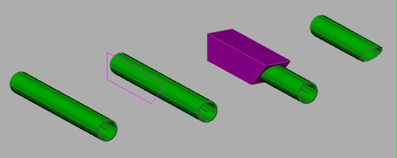

ReMark Posted January 5, 2012 Posted January 5, 2012 To prove that a tube cut at a 45 deg angle at one end could be created without using the SLICE command. I created the above geometry then used the INTERFERE command, electing to retain the interfering objects by removing the checkmark in front of the box labeled Delete interference objects created on Close. Would I ever use this method in the normal course of creating such an object? Short answer: No. But it was fun doing it all the same. Quote
Dadgad Posted January 6, 2012 Posted January 6, 2012 ReMark said: [ATTACH=CONFIG]32071[/ATTACH]To prove that a tube cut at a 45 deg angle at one end could be created without using the SLICE command. I created the above geometry then used the INTERFERE command, electing to retain the interfering objects by removing the checkmark in front of the box labeled Delete interference objects created on Close. Would I ever use this method in the normal course of creating such an object? Short answer: No. But it was fun doing it all the same. That was a pretty devious and creative way to get there, but all roads lead to Rome, eh? How about using the Subtract command? Or Lofting? How did we get started on this Sliceless Slice Jag? Quote
ReMark Posted January 6, 2012 Posted January 6, 2012 I tried the LOFT command but did not have any success. SUBTRACT? Yes, it could be done that way simply by taking the magenta colored object I created, repositioning it relative to one end of the tube then issuing the command. JDM took me to task regarding creating the tube shape with a 45 deg cut at one end. That's what triggered my response. Quote
