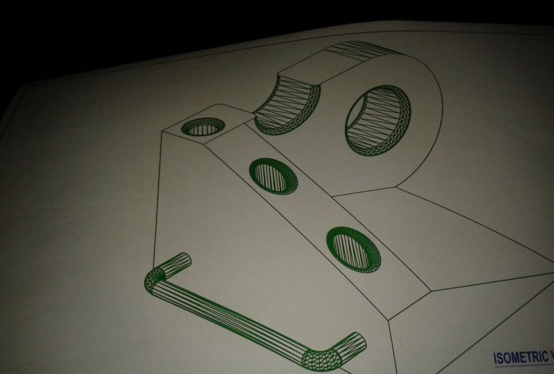

Anyone help on how to do this handle????
Currently studying a CAD course and have got stuck doing this!!!!
Using Autocad 2012 so anyone that could help would be greatly appreciated.
Sweep a circle along the centerline path of the handle.

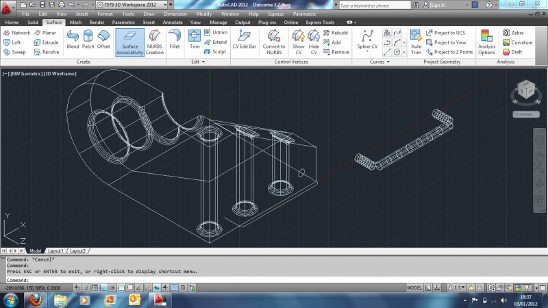

Hi all
I've managed to sweep some of this but it wont seem to do the rads at each end
Anyone help or some ideas would come in handy
Steve
You are talking about the "U" shaped handle on the side of the object pictured above right?

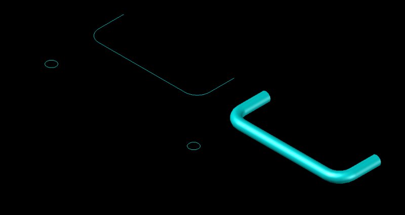

Here's what i have so far just can't seem to get the rest of it.
Bet its simple.
Yes, if you had followed my original advice back when you posted the question the first time (as demonstrated in post #6 above). Create the centerline profile (a single, radiused polyline) then use the Sweep command with the appropriate sized circle. Simple.
I have a feeling you have three line segments and two arcs and that's why you got the results you did. You can combine all these entities into a single polyline by using the PEDIT command and its JOIN option.
Yeah i understand now, I wasn't using a polyline before.
