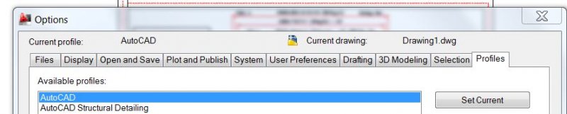

Resetting your user profile.jpgGo to your options (right click in your commandline), or enter OPTIONS in your commandline, then hit ENTER.
Don't erase any profiles, just select AUTOCAD and set current.
Later when you are ready to give Autocad Architecture another shot, select and set that profile as current.

Okay, now on to Profiles. First off, when you are in AutoCAD, you can type OPTIONS at the command line and click the Profiles tab. This is where you can switch AutoCAD Profiles at any time while the program is active. Dadgad already gave an example in his post. If you notice on my screen shot, I have many Profiles that I work with. If you click the AutoCAD profile and click "Set Current" it'll switch. Notice the image below:
