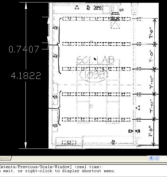

I searched though the existing posts on scaling, but I didn't quite find a solution for this one. I want to change the scale, however there is not an existing one (or it is default I guess).
I am dealing with a scanned drawing so I imported a PDF via JPG and imported it into AutoCAD (2004 LT). Now I want to get the scaling to reflect the dimensions on this drawing. For instance, I know that the light fixture on the drawing is 4' long. When I use the Dimension -> Aligned function it says it is 0.75 units long. How can I change the scaling to reflect that 0.75 should be 4'?
1) Start the scale command.
2) Select the object you want to scale.
3) Choose a basepoint - any point will do.
4) When it asks for the scale type R for reference.
5) Then click the two points that should be 4' but aren't currently.
6) Then type in the size you want it to be, in this case 4'
Thank you Buckingham for your help!
I created a line the length of the 4' fixture so I have an object to select when the scale command tells me to select an object.
I get through almost all of the process, but after I type R for reference it says, "specify reference length " I click one end of the line. It then says "Specify second point" (I click the other end of the line). Then I get a line that is now 5 times as long.
Am I missing something?
Ok, the object you're trying to scale is the inserted image. When you are prompted to select an object, select the image itself. You'll have to click on the boundary.
If I were scaling the image, after I chose R for reference, I'd click on the tip of one arrowhead, then the tip of the other, then type 7'. What should happen is the drawing will scale so that the 7' dimensioned is actually 7'.
