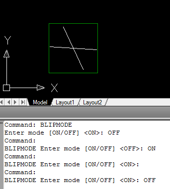

hopefulstone Posted December 28, 2011 Posted December 28, 2011 I don't know what happened with my crosshair but I really can't get it back to original. This s my crosshair. Quote
ReMark Posted December 28, 2011 Posted December 28, 2011 Were you creating a 2D isometric? You could try setting SNAPANG to "0". Is your UCS set to World? Quote
hopefulstone Posted December 28, 2011 Author Posted December 28, 2011 Here you see! It has nothing to do with SNAPANG nor UCS. I have try to repair/ reinstall my CAD, and restore Windows back to early time point. But the problem is still there. Quote
ReMark Posted December 28, 2011 Posted December 28, 2011 Wait a minute. Is that an image of a PICKBOX you just posted? I think you jumped the gun if you already tried a repair, a reinstall and utilizing a Windows restore point. That's akin to swapping out the engine of your car because one tire is low on air. Quote
eldon Posted December 28, 2011 Posted December 28, 2011 I am confused now. Is your cross hair like your first or second picture? The second picture looks like normal, except you seem to have Blipmode activated. If your cross hair is still like your first picture, then were you playing about with 3D Orbit or some sort of 3D viewing? Type Plan, and choose the World option. Quote

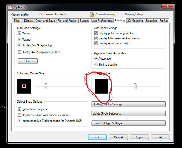

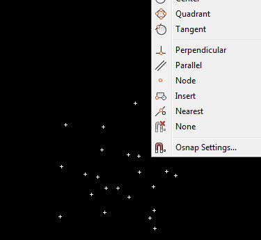

hopefulstone Posted December 28, 2011 Author Posted December 28, 2011 Nop... The 1st picture is before I set SNAPANG = "0" and the second is after. I can't select objects with left button, It make some points instead, and the middle button shows a panel like this. Here you see. There's nothing in Aperture Size!!! Quote
ReMark Posted December 28, 2011 Posted December 28, 2011 So you did at least literally straighten out your crosshairs. Well it's a start. If you press the F7 function key do the little white crosses (pretty sure they are blips) disappears? Yes/No/What are blips? Quote

hopefulstone Posted December 28, 2011 Author Posted December 28, 2011 yap... the little white crosses disappear Your crosshairs are the same color as your background, change them to something else. of course not ) Quote
ReMark Posted December 28, 2011 Posted December 28, 2011 Alright. That means you had BLIPMODE turned on. How you managed to do that I can only wonder. BLIPMODE can be turned On/Off via the command line. Just type BLIPMODE and reset it should you encounter the problem again. So, to recap, we have crosshairs. Yes? We have no more "blips". Yes? What's the next problem? Quote

ScribbleJ Posted December 28, 2011 Posted December 28, 2011 Make sure the AutoSnap Settings (as shown in the image on the first page; upper left corner of the bottom image) are checked. I have noticed this happening before and had the same results. Quote
