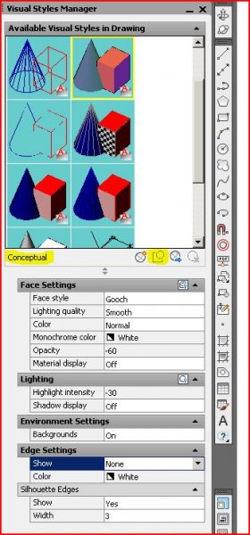

I am a student and in my school i am enrolled in an introductory autocad class. During one of my projects i made a castle. My problem is in conceptual view, there appears to be 3d wireframe and conceptual view are overlapped. This also causes me to not be able to render my project with the assigned materials. I do not know what version of autocad is being used. How do i fix this so i can render the castle and also fix it if the need arises in the future?
without seeing the actual file, it's hard to say for sure but it sounds to me like you were in a shaded mode with edges turned on. If you can post the file or even a screen shot of it, that would help.
I agree with Jack's assessment, sounds like a VISUAL STYLES MANAGER issue, perhaps your display edges needs to be reset to none, in the CONCEPTUAL visual style. Reset the edge display to none, then clcik on the other yellow highlighted button, to apply the new style to your drawing.
