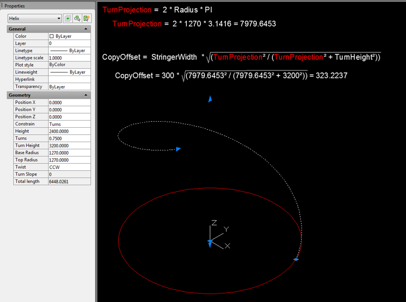

robindemey Posted January 4, 2012 Posted January 4, 2012 That's the problem. When I extrude the line (the helix), I can give a height. But this number 1 in my drawing and that's not what I need. Quote

robindemey Posted January 4, 2012 Posted January 4, 2012 Final result should be something like that: http://www.cadtutor.net/forum/showthread.php?65439-Winding-Stair-Stringer-Issue&p=447002&viewfull=1#post447002 But I'd like it to be smooth. Your pythagoras isn't correct, because I only know 1 side (height 2=300). The angle of the stringer is'nt easy to know, because it's a helix. Quote

SEANT Posted January 5, 2012 Posted January 5, 2012 It requires some pre-processing before applying the Pythagorean theorem. The attached DWG is based on an arbitrary turn count, rise, and radius. I did base the stringer width on 300. Example.dwg Quote

stevsmith Posted January 5, 2012 Posted January 5, 2012 I find it easier to draw a spiral stair for manufacturing using plain 2d and manually working out the development. I think you'll find thats why it could be tackled long before computers. Quote

SLW210 Posted January 5, 2012 Posted January 5, 2012 You are not going to fabricate the stringer in one piece, so why draw it in one piece. Like stevsmith stated, for fabrication drawing, work out the development in 2D or you can 3D this, but in the same manner as constructed. It can be fabricated in one piece, if you have the equipment and material. I would make it so the pieces were less than 50 lbs. Quote
