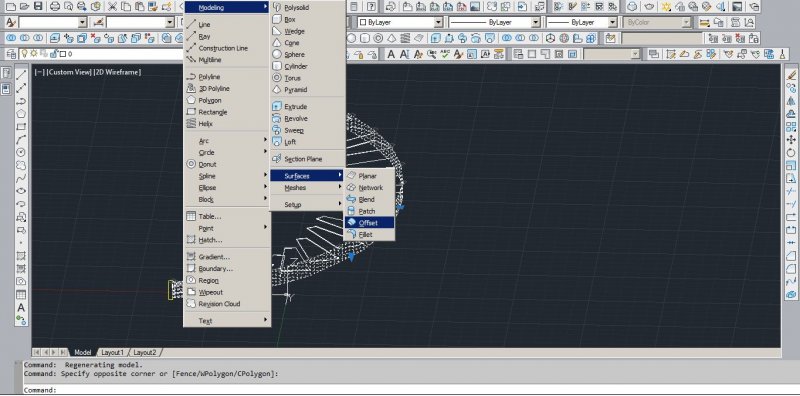

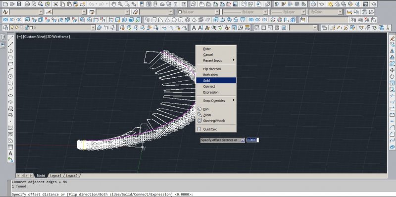

robindemey Posted January 4, 2012 Posted January 4, 2012 In AutoCAD 2012 extrude the 3d polyline to a suface, then offset the surface to the needed thickness using the solid option.[ATTACH=CONFIG]31927[/ATTACH] I have the same problem. The solution from dedmin looks great, but I still can't do the following: How do you exactly choose the hight of the stringer? I have a helix that I'd like to extrude to a surface and then give a thickness. But the stringer has to be exact 300mm high. The stringer will be made out of stainless steel that will be bended (I don't know if that is the correct English word). Quote
