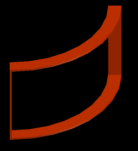

ReMark Posted December 24, 2011 Posted December 24, 2011 I created this frame using some of the geometry that was in your drawing. I was able to extrude the two horizontal parts of the frame with no problem. For the two sides, I first changed the orientation of my UCS, then I used a 3Dpolyline to create a rectangle that I extruded. Finally, I unioned everything together. The width of the frame is 4.0 just like your other frames. Quote
fourleafclover Posted December 24, 2011 Author Posted December 24, 2011 I have got the frame to the first stage of extruding the two horizontal parts, so now I have aligned the UCS so that x is parallel with the vertical side and have created a 3d rectangle polyline, but now when I extrude this it is obviously straight and doesn't curve. I know this is really easy but I just can't seem to get my head around the curve! Quote
ReMark Posted December 24, 2011 Posted December 24, 2011 I did the same thing yet if you look at the image I had no problem with it when everything was unioned. Quote
