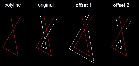

has anyone noticed that the offset command has changed in 2010? (unless i am going mad) see image below. i'm sure if you offset a polyline, with no node at the crossing point, in pre-2010, it would end up as second image.
but now i get the 3rd and 4th types, which i admit is pretty good for offsetting both sides and deleting original construction line, but not always better that the original method.
is there a variable or option somewhere to change the performance?
thanks!
thanks!

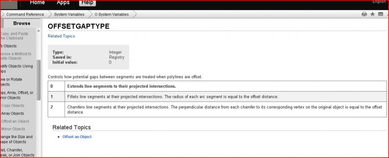

There are some interesting choices in the offset commandline options. I have never used it, but the layers offset could be useful in Landscape design or other Topographical applications. Perhaps you would be more comfortable with one of these other offset gap types.
yes i looked at the OFFSETGAPTYPE variable for the first time ever today - but all this does is set the connections between polyline segments to chamfer, radius etc. i think this problem comes before that variable, if that makes sense.
I just tried the offset command as shown in your pictures in ACAD 2006 and I got the same results as the 3rd and 4th images. It may have been changed in earlier versions though.

I think that you may be going mad, unless you updated from a long, long way back. AutoCAD 2002 produces the 3rd and 4th images.

well that is interesting. thanks mike and eldon, i was beginning to think that must be the case. could find no variable for it, no clever options. must be mad then.

I tried on 2000i at home yesterday, it is the same as on 2011.
