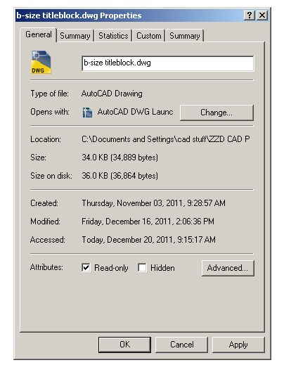

There's a couple ways to get around that. One is to use the Windows explorer. Find the file, right click it and go down to properties. Uncheck the "read only" box and hit ok.
You'll have to have sufficient user privileges to do that. Another way is to simply do a "saveas" and name it something else. This will create an editable copy, leaving the original intact.
