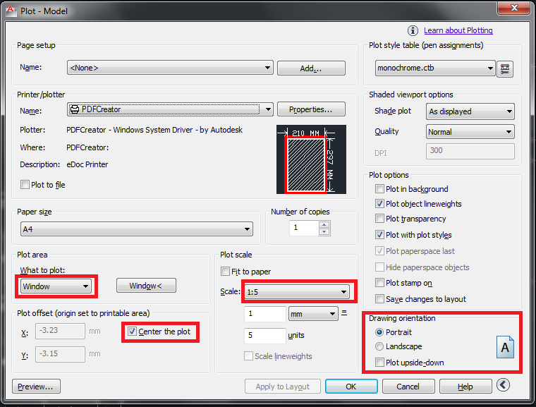

You can change the default plotting manager (the window you see when you press CTRL+P), by typing "pagesetup" end edit the default.

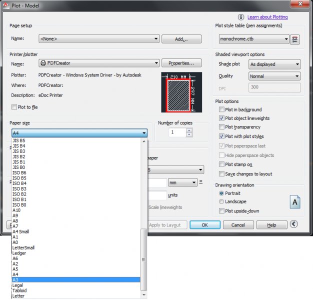

in this window, you can select A3 as the paper size as shown in the picture below.
if you want to print an A3 layout, you can select under "what to plot", the window tab and you will be prompt for an window. In the scale tab you can set the scaling.
I reccomend selecting the "Center the plot", because this will center the selected window to the paper.
Then set the drawing orientation to the needed orientation.
