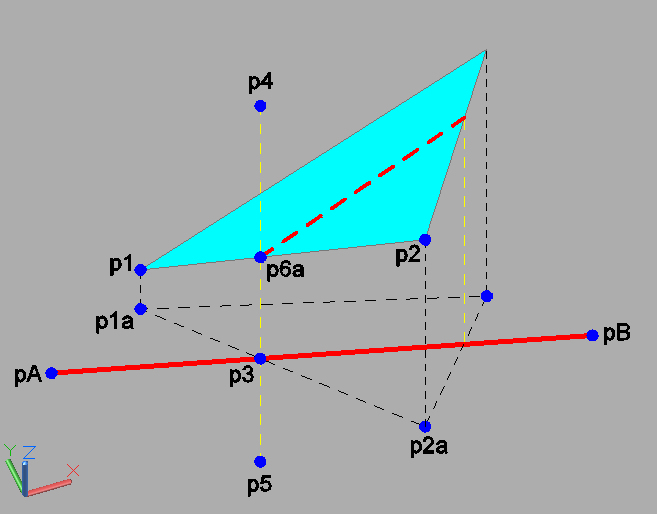

hi friends i have a program ezysurf this program can draw a cross section or profile by drawing a line on a surface this surface consist of a 3d face for every three points and the 3d face lied on a specific layer the question is can any body help how we can get the list(x y z) of intersection points between this line and the edge of every 3d face in addition to start and end point of this line

Can be done you need to create new lines representing the faces say on another layer then you draw your line and do a "intersect" for every line it crosses giving the point required.
this is just a start but is in right direction need a 3dface to lines to test explode all 3dfaces.

See if you take a cue from this (bad) English version of my lisp.
Description: selecting a line/polyline2D/polyline3D that intersects a surface consisting of triangular 3DFACE, generates a polyline3D (profile) on the model.

I respond publicly to a request for explanation on Lisp received at the private message as it may interest to other users.
_______________________________________________________
Intersection section line/3DFACE
Repeat for the three sides of the triangle (3DFACE)
  • pA pB -> points of the section line
  • p1 p2 -> vertices side of the triangle
  • p1a p2a -> vertices p1 and p2 to altitude 0,00
  • p3 -> intersection of pA,pB/p1a,p2a
  • if p3 ->
    • p4 p5 -> points on the vertical p3
    • p6a -> intersection point (in top view) section line/3DFACE
Point in the plane of 3DFACE
Use: Help AutoCAD
This is the use in lisp posted:
(cal "pINT_z=ilp(p_INT_inf,p_INT_sup,p1,p2,p3)")
Note: remember to load the geometry calculator:
(if (not (member "geomcal.arx" (arx))) (arxload "geomcal"))
