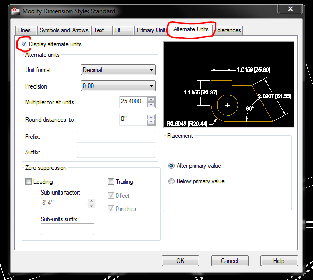

your advice was useful, nevertheless it is a diffrent point,
my problem is to draw two parallel dimensions in exact distance, for example 8mm
Using the Alternate Units method is the preferred/standard way of depicting two sets of dimensions.
