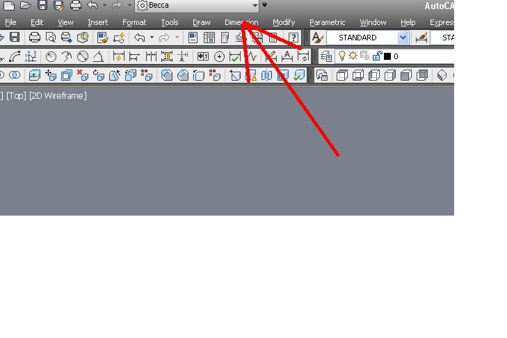

resullins Posted December 15, 2011 Posted December 15, 2011 Go to Options > Profiles Tab. Export your current one to a folder you'll remember, and then copy it to your USB drive. In your WORKSPACE drop down menu, save your current profile to a unique name... see attached picture. Go to C: > Program Files > Autodesk > Autocad 20xx > Support. Copy that whole folder to a USB Drive. Go to C: > Documents and settings > > Application Data > Autodesk > AutoCAD 20xx > R18.2 > enu > support. Copy that hold folder to a USB drive (remembering that you'll have to give them two different names and them change them back later, or you'll overwrite whichever one you put in there first.) Then redo all this after you reinstall. In reverse order, of course. Quote
