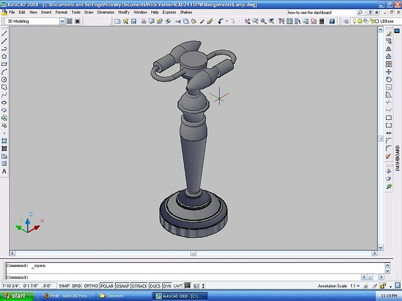

Is there a way I can make this lamp Solid? It was created using Revolve.
Any suggestions are appreciated.
Revolve happens to be the solids equivalent of revsurf.
so this is your project , duh... what do you mean solid? as in all of your components be united as a single object? try union. if there is a mistake in 1 of your objects, try to press ctrl, then delete the mistaken object. (cad 08')
I was having trouble rotating this as one single polyline because of an imperfection in the original profile. Once I found the imperfection revolved as a single polyline and the lamp is now a solid object.
