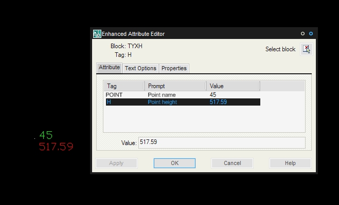

so, as the title says, i need a lisp routine that changes attributes of block.
specificaly i need to change an elevation of multiple points in a block.

and also it changes the entire elevation of points, but i want to addict or substract an original elevation to new one. per example: if i had a point that has an elevation of 230,33 and want to "drop" this elevation for 0,5. so a new elevation would be 229,83.
so if i would change this elevation for multiple points it would substract or addict all elevations of selected points by 0,5 (or some another value, that i determine).
i have attached one picture of how my block of points look like
i would be glad if anyone can help me.

this lisp is still changing my point number and height instead of just point height.
if i want to decrease point height by per example 1, it decreases point height from 300,00 to 299,00 and point number from 45 to 44. i want that point number 45 would remain the same.
would you change that for me, cause im not that much expert in lisp.
thanx :)
one more thing,
by point number i mean point name, as shown in attached picture above.

Check this one ....

im trying to understand this lisp code and can someone explain me what means this part of code: "((0 . "INSERT") (66 . 1))"?
those are filter list used in conjunction with ssget, which means only entity properties listed will be included on the selection
where
0 is object type
66 means “Entities follow” flag
Variable attributes-follow flag (optional; default = 0); if the value of attributes-follow flag is 1, a series of attribute entities is expected to follow the insert, terminated by a seqend entity
